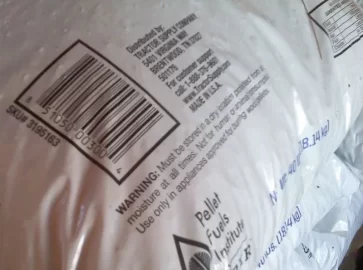

I was getting low so went out yesterday and bought 25 more bags of Statesman Hardwood Pellets at the SS Co-Op because I know that my stove loves them ... but on the way home I slipped by my local TSC and pellets were $4.99 a bag, it's a white bag with blue writing but I didn't see "ProPellets" wrote anywhere. Bought 10 bags ... first one is about gone .... my stove seems to like these as well! It is a little softer ash that falls off the burn pot into the ash tray.
Are these ProPellets?View attachment 194055
[Hearth.com] From Propellets to Appalachian in a Serenity
if you post a pic of the UPC code I can scan it
Jesus, people!
why are you up this early?! ;em
I was up getting ready to leave for my son's wrestling match.
Reactions: Talegas
Thanks ...... It's:
8 51050 00300 4 on that one bag of the ten I bought, the other 9 bags are 7 49394 10780 2 .... and the newer Statesmans are 7 56637 28297 4 ..... I guess I could google them?

the bag in the pic is appalacian, the 074 bags just come up as TSC
