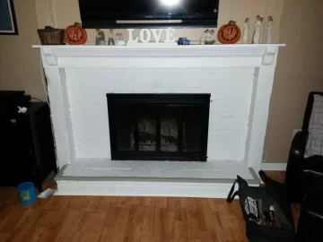

Attached is a picture of our current hearth where the Accentra will go. From the fireplace opening to the front of the current hearth is 15", exactly how far the Accentra sticks out.
That is an approved product for hearth protection. It DOES NOT need to be attached to the existing riser. It will definitely move on a hardwood floor, though, so you may want to try to try to secure it. Something as simple as a few goobs of silicone will probably work.
