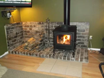

Not the same situation because I do not have carpet but when I went from a side loading thinner front to back stove to a deeper front loading model I needed to add something to increase front clearance/floor protection. I cut out the wood floor, and added tile over dura rock. This kept the floor essentially level so the hearth did not eat up to much room space and avoided creating a nasty toe stubber sticking out into a dark room. Just an idea. Tile installs low enough to be on level with the carpet so a vacuum can roll right across.
