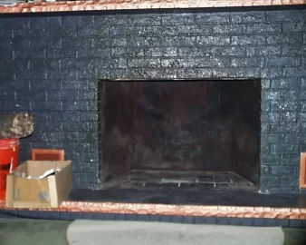

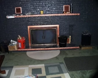

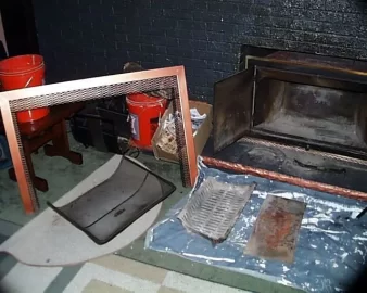

Well pulled the old Feugo Flame out yesterday. What a chore that was. Appears it was set in what might be an old (60's) heatilator premade steel. Steel was about 3/16" thick double box with inner & outer shells. I am going to do photos in a sequence. My apologies if its too much.
Begining demo:

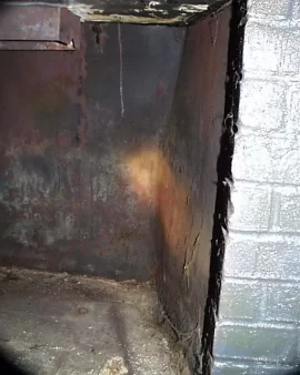

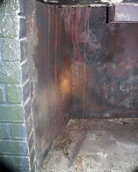

The original existing took a pounding at some point. Back & side walls have some serious buckles:
  • [Hearth.com] Fuego Flame yer gone! Theres a new Summit in town! Demo & prep photos.

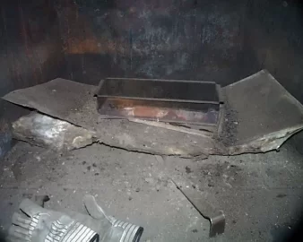

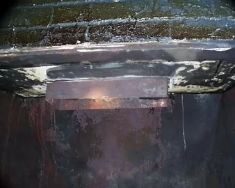

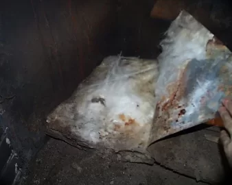

Was a direct connect, looks like they did it right anyways. Had 2 layers of sheetmetal with what appears to be rockwool sandwiched inbetween for a block off plate.? I don't honestly know what rock wool looks like. Am going to need some for the new install though. Any ideas where to get it?

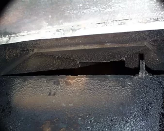

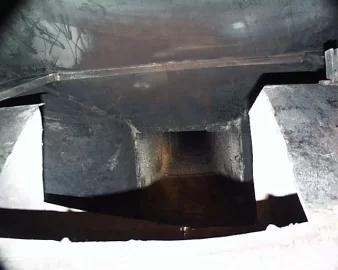

Original damper was good size, but door already out when old insert was installed, now I had to cut through with a sawzaw & angle grinder, man that was definitely the worst & dirtiest part. But I dug in my heals and went to town. Now the new liner will almost make a straight run. just a very little snaking and it should go fairly well.

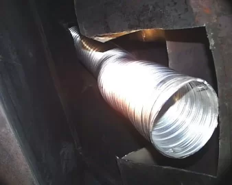

To mock up the liner, I bought a section of 6" aluminum flex & an adjustable elbow at HD for around $12.00. It worked out great for figuring what I needed cut out and what angles the flex would take when it is run through. I just have this one resting on the lip of the damper cut. I couldn't hold and take pic at same time. I had to hold a flashlight in one hand for most of these interior fireplace photos, cause the camera wouldn't focus without the light. Camera in one hand, flashlight in other. It was loads of fun.(Sarcasm).

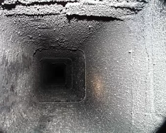

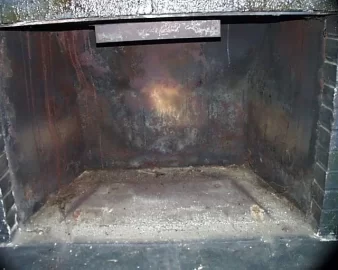

I will be cleaning my own damn chimney for now on, I paid to have this cleaned out and they did a shoddy job. I was just starting out and didn't know any better.
BTW I cleaned the inside of the old fireplace with a 6" spackling blade. I was literally top half of me in this fireplace LOL. And I am 6'2". Our youngest boy asked if I was going up the chimney LOL. He is obsessed with Santa, and said Santa would be coming down this Chimney. The kid looks at every house we drive by and says...."theres another chimney, Santas going to go down it". Hes 7, cute kid. Always noticing chimneys LOL.

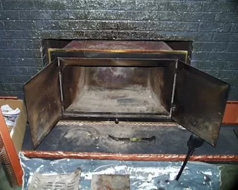

And wallah, the old insert out, the Summit sitting literally a couple feet to the right. Cmon liner!!!!!!!!!
