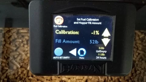

Gotta question regarding my Harman TC Absolute. Since joining this site I have received some great information concerning my stove from cleaning to settings. I began playing around with the Fuel Calibration settings after reading the manual, reading some information in the forum and watching a few of Harman’s videos, which Harman is currently on my chit list. I for the life of me cannot figure out what the Fuel Calibration is for or what is supposed to be the end result. Any information would be appreciated.

I believe this just calibrates the fuel usage to estimate the amount of fuel remaining, a problem easily solved by looking in the hopper.
Thanks for posting your thoughts and wants on the Absolute stove. I have one and love it, is my 2nd Harman, previous was a Accentra for 12 years. I have questions my dealer and can't get a good answer either don't feel bad. I guess if someone asks how many pounds of pellets you use a day you can tell them. You can change the hopper size, calibrate to whatever. I guess you can calculate how much you use from one brand to another. And you can update your stove if there is a change in operation which i have never to update using my laptop. Dealer has never contacting on my questions. On the other hand I like the daily 4 time settings for the temperatures. I believe it saves pellets. Anymore thoughts??
That's what I do not understand because there is a feed rate and a feed calibration. I dont have any problems but like to know how things work and the purpose for them.
