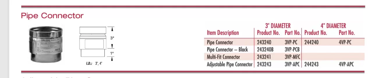

3"Diameter Item Description Product No. Part No. Product No. Part No. Adjustable Pipe Connector 4"Diameter 243243 3VP-APC 244243 4VP-APC
Sizes: A B C D 3VP 3 ½" 3" 1" ¼" 4VP 4 ½" 4" 1" ¼"
What about the Adjustable Pipe Connector? I'm sure you already looked at that. I guess the Harman's are 3"?
I haven’t tried the adjustable, but the “B” dimension there is listed at 3” which is the same as the multi fit connector. The multi fit connector also uses a hose clamp and split pipe for adjustment so I’m concerned the fitment would be the same. The ID of the Harman exhaust is about 3 1/8” and the OD is about 3.5” and tapered. The multi fit connector would not expand enough to go over the 3.5inch OD on the Harman.

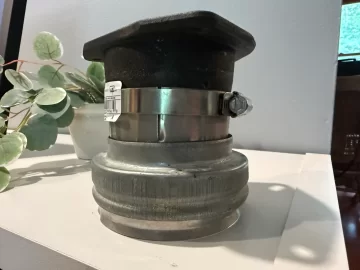

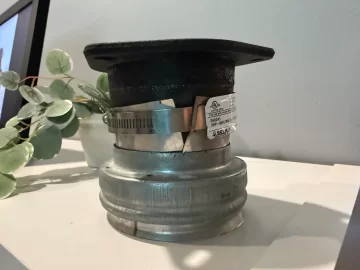

Here’s a picture of the multifit connector trying to fit but not stretching enough. The OD of the 3” outer wall here is 3.5”, which aligns with the adjustable connector. That’s why I’m questioning if the adjustable would work or if it would be the same issue.

I was looking at the drawing and the specs "3VP 3 ½" 3"

Is that black part with the flange from the stove? I guess my guy must have removed something like that in his shop and installed the proper Harman Adapter for my pipe system. Ya that sure looks like a mess. There should be a single wall to double wall adapter that fits over that black stove part.
You are right the drawing does list the A dimension as 3.5 inches, but my interpretation of A is the outside diameter. It could also be the maximum opening it can adjust to, but unfortunately it does not say in the Selkirk catalog. Here’s a screenshot of the Selkirk catalog and another from north line that seems to indicate it as an OD.
Yes the black part is the flange off the stove.

OK, yes that is a great picture. I can see now it is meant to slide onto 3 inch.

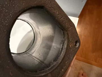

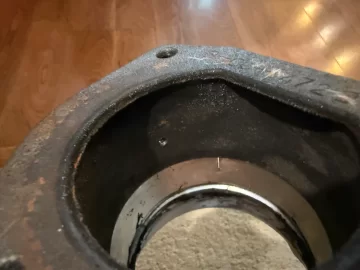

What are the dimensions of the Enviro stove exhaust? The Harman ID is 3.185”
The OD is tapered. It starts at 3.435” and tapers up to 3.625” at the base of the flange. So even if it expands to 3.5” it will not fully go over the entire exhaust.

I have the factory Harman exhaust. As you can see they are oversized compared to other manufacturers.
On my fourth call to Duravent I finally talked to someone in the technical department that knew what they were talking about. He was very knowledgeable and said he has installed many pellet stoves as well as worked in the factories where they build the vents. He said on Harman it is common practice to slip the exhaust between the outer and inner wall and seal it up with silicon and use screws to secure it. He even mentioned using a crimper to downsize the inner wall if needed to get it started. I bought a standard 3” appliance adapter and the Harman exhaust fits perfectly between the inner and outer wall. I don’t love doing it this way but it’s a tight fit between the inner wall and exhaust so I’m sure it won’t leak with some high temp silicon. I’ll tape over it as an extra measure. This is how the previous stove owner had the Duravent installed so maybe it’s ok, I think they had a Harman dealer install it. Just seems like that section of pipe is going to run hotter as it’s not really a dual wall installed like this. I’ll keep an eye on temps and for leaks the first few burns.

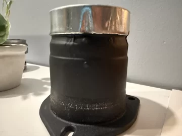

The cheapest, most efficient way to do the Harman tailpipe…have a 3” OD or ID pipe(or size desired) welded to the flange…I’ve been through the above and ended up welding my own and reinstalling it. my apologies for not seeing and answering sooner
