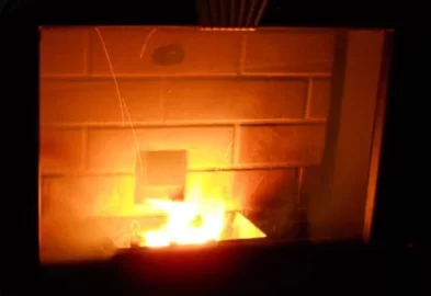

Looking Good..... Gotta love a clean stove.
What setting is the heat level on? (For that flame size/ 3?) Just wondering. I have been looking at an M-55 steel. But that CPM is a Beauty too. Decisions, Decisions, Decisions ......
Good job
Just curious...how long did that cleaning take you?
Good job
That is on 5/6....the flame was just small for a minute between small auger dumps. It was higher than that before & after the pic.

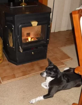

Here's a non-flash pic:

I like the doggy!!
Bank said:
I like the doggy!!
Yep, she's a cutie. I got her from a shelter, and was told she's a Border collie, but I think she's a McNab variant. Lots of energy, very loving, and HAS to sleep on the bed at my feet. :)

Is that the original paint job on the brick's?
Yes ;-) , and yes.
Looks to be holding up nicely. I have to paint my baffle ever year. What paint did you use?
