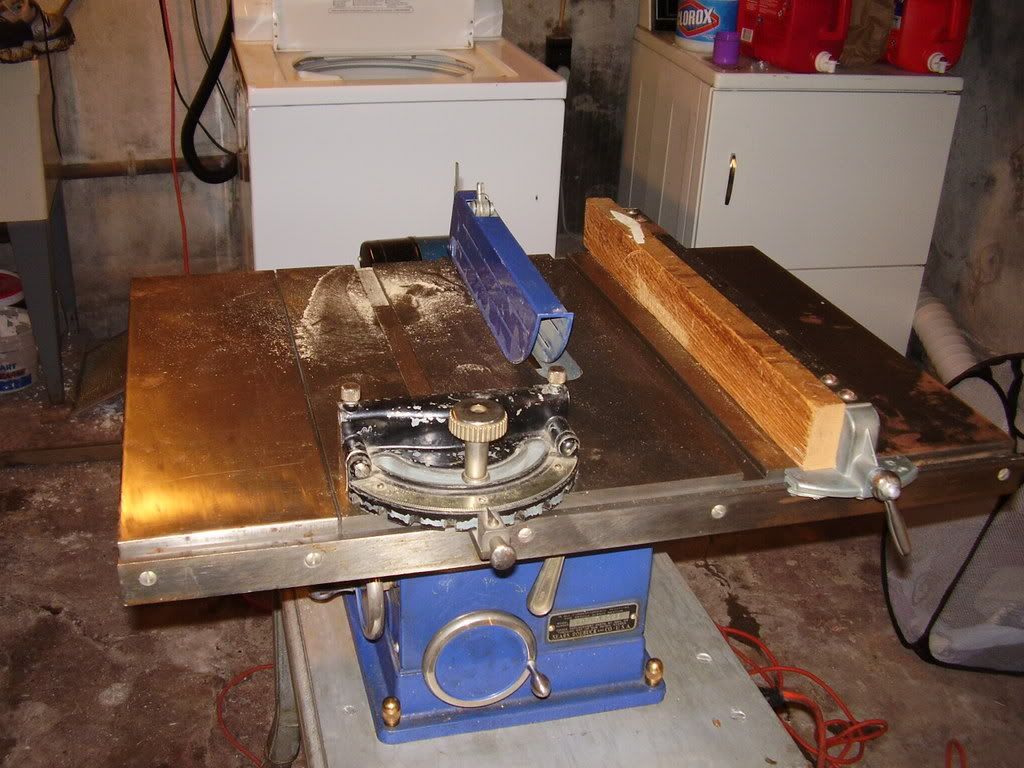

We've got a newish (last 5 years or so) craftsman table saw at work.... AL table.... what a POS.... I had to fabricate a stand for it (it has legs) to keep it from tipping over while ripping a sheet of plywood. *My* table saw is the ubiquitous 10" craftsman belt drive.... iron table... I love that saw.... (The bessemeyer fence doesn't hurt). the only thing I wish it has was a dual voltage motor like my dad's 10" belt drive...
Reactions: ScotO
I make do with a Dunlop 8" tilt table. I try not to break down sheet goods. I have a couple friends with unisaws and such that I can use also. When I finally get the inside of this house done I'll be able to focus on putting a shop together again.

The miter gauge walked off when I was trying to sell the house that the saw was sitting in. Grrrrr....
