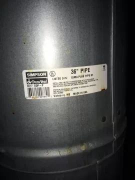

well friends.... Its been a few months. I got possession of the house 6/1, and I havent had a spare minute since.
Fall is approaching and I do not have a heating plan yet. I have a gas furnace, but I have no tank or propane. But the local co-op will rent me a tank and some propane.... for a fee of course. I will have to buy wood this season at about $150/cord. Probably leaning towards the Tundra II at this point. It appears that I can get it to my house for under $2k. Also I have inspected the flue that the previous owner left me.. its (see attachment) this stuff all the way from the basement ceiling through the roof. From my research, it seems like the existing flue is made of quality product and should work well.
  • [Hearth.com] Furnace Recommendation
Get your propane furnace operative ASAP. Wood is of secondary importance to a thermostatic, automatic, heat source.
Then, the tundra 2 is a great furnace.
$150/cord sounds like a decent price...also sounds "seasoned"...which in Indian means "not dry"...which will leave you frustrated with your new furnace. But you can supplement with slabwood, free used pallets, or a pallet of "ECO" bricks to help get you through this first winter...better order extra wood for next year too...get it started drying now.
