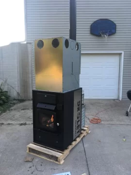

Well my first fire went okay tonight. 6’ flue and 85 degree temps didn’t help my draft much. Had to keep the damper open just to keep the fire going. The blower kicked on probably 25 times in about a 2 hour span and it also stayed on for 3-5 minutes at a time. Seemed encouraging. Unfortunately every time I got a good secondary burn going and I closed the damper, I would have a full on smolder within 5 minutes or less. ( has to be due to low draft) Amazing watching the smoke go completely clear once I opened the damper and the secondaries got going again. I also heard one rather loud metal pop that has me a little concerned. Is this normal? Like it was loud enough to interrupt a conversation. There were lots of little pops and creaks.
  • [Hearth.com] Furnace Recommendation
Blower on n off is due to low static pressure, (at least partially) and low draft...pretty normal in these temps.
The loud pop...not "normal", but not uncommon either...have had it happen myself, on more than one model stove...look it over good, but its more than likely fine.

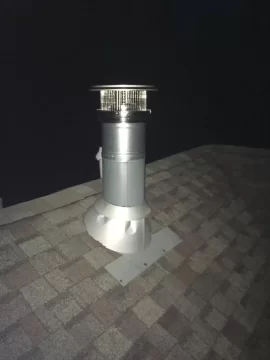

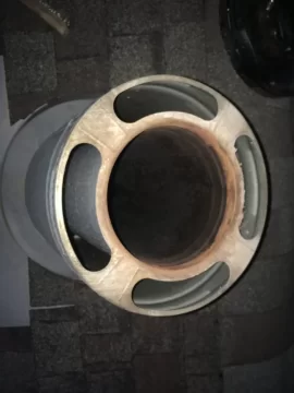

Flue pipe self inspection tonight was a bit interesting. I’ve only lived here a few months, but quickly learned there was no cap on the flue (rainwater and washed out creosote on the basement floor) Thankfully there’s a floor drain within 2 feet. Previous owner left the trim ring portion of the cap on, but not the rain cover for the main tube. Trim ring did cover the air gap between 2nd and 3rd pipe layer. I took this ring off and found some corrosion but everything seems sound. Thoughts?
See picture.
I put another 9” section of pipe on to get closer to the 3’ clearance over the peak (probably still only 2.5’) and then a new rain cap. See picture.

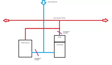

I am working to get the duct installed in parallel with my LP furnace . See attached diagram. Any thoughts? Do I really need the dampers on the cold air side? It seems that the hot air dampers would minimized backdraft, but I am concerned that the LP furnace could suck hot air off the wood furnace through the cold air.
Dad did help me size the duct. I am planning to run a single 14" round duct from wood furnace plenum into the plenum above the LP furnace A-Coil. At 1400 CFM, this should give me close to .2 static pressure. If I need to run at a lower speed, I may put a damper in. I cant remember what size duct we decided on for the cold air, but I have it at home. We sized it larger than the hot air duct though.
I don't think you need dampers on both sides of both furnaces...1 on each should do it. What I would do is put one on the LP furnace supply like you have it in the drawing...then one on the return air duct of the Tundra. Reason being, for gravity flow on the Tundra if the power goes out...you'll notice the air filter/blower box is not 100% sealed up on those...they do that (leak) on purpose to make so it can easily get some airflow to cool itself on power failure. My Yukon furnace actually has a 1" gap on one side of the air filter for this same reason.
And don't worry too much about hitting .2 SP when you start it up...if you do, it will do nothing but cycle on/off all the time (unless they changed more on the T2 than I think they did) Setting up a wood furnace is a lot different than a fossil fuel furnace...on those you just set the SP and/or temp rise, good to go.

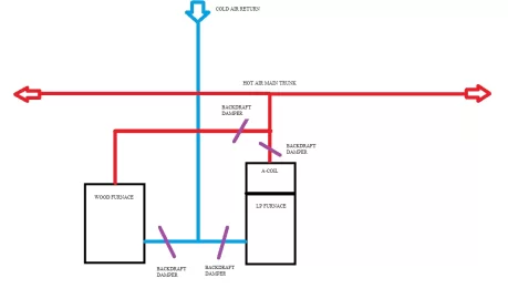

Great suggestion! Thank you! I have revised my diagram.
I may just use a manual "slidegates" as backdraft dampers for now (with gas furnace switched off). We will see how well this thing heats the house. If it cant keep up, I dont want to be pulling out the "slidegates" every time the gas furnace needs to run. In that case, I will spend a few extra bucks and buy or make something with louvers that will open and close on their own based on which appliance is running. Then Id also have to interlock the gas and wood furnace so they cant run at the same time, but also prevent the wood furnace from overheating.... we will cross that bridge later!

Yeah I think that should work...maybe another "air scorcher" here can look this over to make sure I didn't miss something though...and if you are going to do the manual gate thing, a piece of cardboard or tin slid behind the air filter works...just don't forget to pull it out when the furnace is started back up!

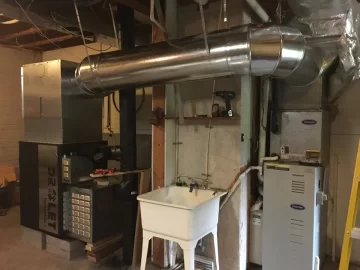

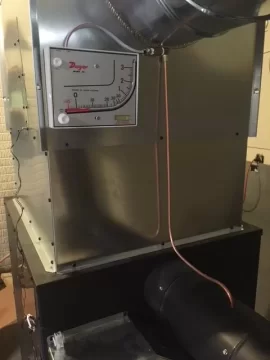

I’m about ready to fire it up! Everything is plumbed except the cold air return. I will have to set the barometric damper and monitor temps pretty closely on the first burn. Also still need to notify insurance company.
Excuse the filthy basement....

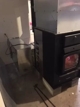

I am not real sure my return air is setup how I'd like. I ran the furnace a few times with the furnace just drawing from the rooms its in, and it seemed to heat up the house fast. Like 5 or 6 degrees in a couple hours. Now that its plumbed into the house return air duct, I get 1 or 1.5 degrees of change per hour. It seems that if I let the return air suck from the ceiling of the furnace room, while leaving the house return air duct open, I could draw in warmer air, while still having a place for the room to draw air from, thereby not holding back the blower any.....
Ive attached a few pictures of my setup...
