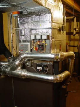

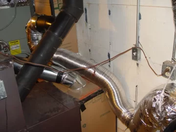

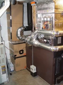

Sure, but there may be some :rolleyes: , ;lol and :eek: responses. Red Green would be proud, but disappointed I didn't use more duct tape. ;lol
A few years ago I experimented with using Home Depot boxes to box out the intake of the cold air and bring it up to the basement ceiling. I saw immediate results and left it like that. The following year I wanted to have it made permanent by using sheet metal and had two HVAC companies come out to give me an estimate to have it done. They both left stating I would hear back from them shortly. It's been years and never heard squat. My guess it's way too small of a job for them to come out by us to do. So, my HD boxes still remain. Fugly, yes, but also functional and that's all I care about. If I knew what I was doing I could do the sheet metal myself, but I don't so I won't.
The rigid ducts run from the front of the Kuuma to the rear "box out" of the return and suck/reclaim some of the radiant heat off the face of the furnace, at the hottest part, where it mixes with the air being pulled off the basement ceiling and then sent through the furnace jacket to be heated before being sent out to the house. The whole basement still remains heated quite well just with the leftover radiant heat.
Seeing I'm sure I'll be asked about the duct connected to the BD, I figure I'll explain it. It just goes to a cold air make up air vent on the outside of the house. It sends unheated outside air up the chimney instead of using heated basement air to regulate the draft. Ran it this way since February of last year with no issues, even though I'm seeing stack temps right at the collar (before they get mixed with the outside air) of down to the 270° range when on pilot. No issues with condensation or creosote. I also have a tee and 4" reducer in the makeup air duct near the floor which points at the ground in order to provide makeup air for combustion, LP drier and the LP Power Vent water heater.
BTW, the extension cord in the photo is no where near as close as it looks. I have since routed it up and out of the way of when I remove the stove pipe at the end of the burning season.

Seeing I'm sure I'll be asked about the duct connected to the BD, I figure I'll explain it. It just goes to a cold air make up air vent on the outside of the house. It sends unheated outside air up the chimney instead of using heated basement air to regulate the draft. Ran it this way since February of last year with no issues, even though I'm seeing stack temps right at the collar of down to the 270° range at times when on pilot. No issues with condensation or creosote.
Which you would only get away with this on a Kuuma...nothing else burns clean enough to not creosote the chimney up with these low temps. No smoke, no creosote.
