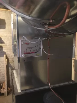

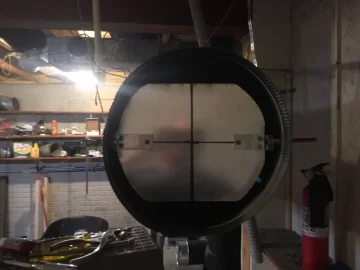

I did however finally get around to hooking my manometer up to my hot air duct. My initial readin was 0.03!!

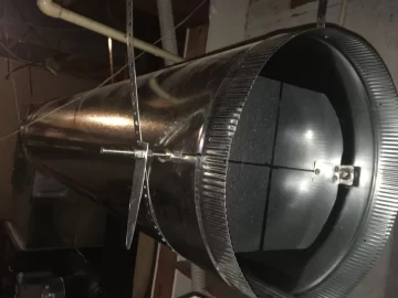

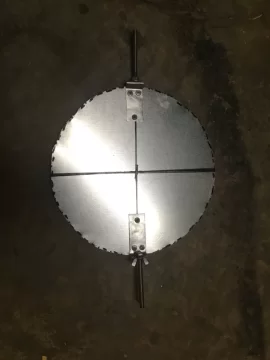

Since I had some spare sheet metal around, I decided to make a damper for my 14” main duct. See attached photos. At furnace speed 1, I’ve now got 0.2 in H2O. I just did this tonight, so I haven’t had much time to evaluate the possible benefits. Air velocity at the vents is obviously decreased quite a bit, but hopefully the fan will stay on a lot longer. Time will tell. I’ll report more later.

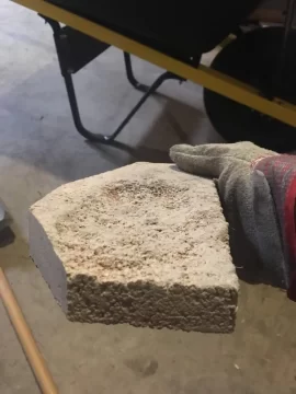

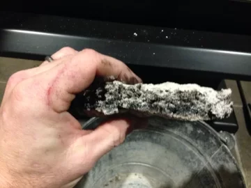

Recently I have been burning lots of elm... and unfortunately, I’ve had tons of “clinkers” getting stuck to the front firebricks. The front 2 are basically destroyed. I have a lot of elm left to burn... anyone think there would be a problem with installing a thick metal plate over the firebricks in the floor? I’m going to replace these firebricks and would really like to keep from destroying them again.

Leave and inch or two of ash in the bottom...clinkers won't stick, and they hold coals better this way on a long run too

Clinkers: bits of sand and dirt in (or on) the wood, that melt and turn into a lava-like substance. In my case, the lava is seeping into the voids in the firebrick and becoming permanently attached. They only seep in so far, so the remaining amount protrudes from the brick. Once the fire cools, these clinkers become hard as a rock, and nearly impossible to remove from the brick without damaging the brick.
Some types of wood tend to have more of this “contamination” than others. Red elm seems to be very bad. These only form when the fire is very hot. All of mine have occurred in front of the ash pan hole, where the combustion air heats the coals.

I get a few, burning mostly sugar maple. But they are never a problem, just look like a hard coal in the ash. I also keep a bed of ashes of an inch or two in my box. Really helps protect the refractory.

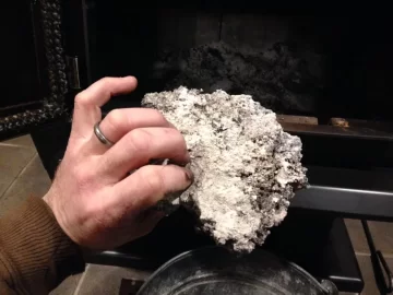

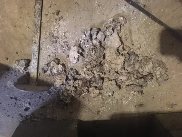

Here's some of mine. Evergreens have thick bark and tend to make these pretty easily.
