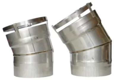

It may need an angle connector and he didn't have one on the truck. Can you post the picture that the sweep took?

This is what an angle adapter looks like. They come in 15 and 30º.
