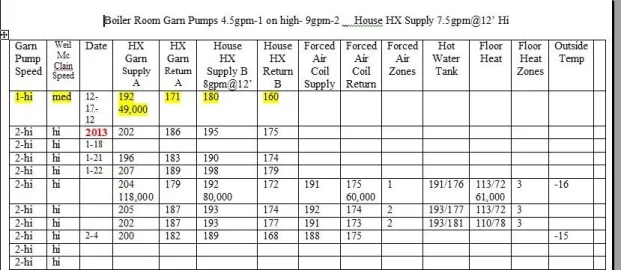

How Close do you want to get the A in/B out differential. Wouldn't pump flow and demand make a difference between systems. I have always had a 10-12* differential, do you think this is cause for concern?
I think your right.Pump speed and demand would make a differance I would be happy with a 10* spread
I haven't cleaned out my HX since it was installed. I'm within range of what you guys are seeing.... 10-12 degrees difference. This number narrows the faster the pump runs (variable speed pump).
