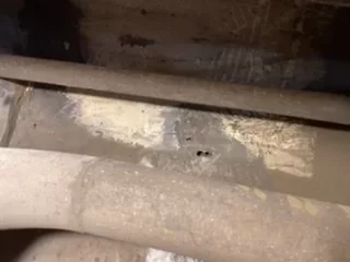

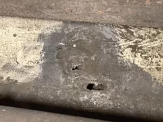

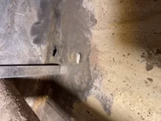

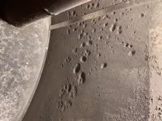

Here are the pictures of what I found inside of the tank. The first picture is the hole on the back wall of the tank an inch or so above the bottom.. The next picture shows the heavy pitting there was under the sludge at the front of the tank. There was similar pitting at the back of the tank as well. The last two pictures show the bonus holes that I found
5857A095-2E2A-4807-A53B-504214A3B10C.jpeg B3FF00BD-15CF-4560-A76F-442940A7840D.jpeg 05CD08A2-13B3-4DC4-B0CE-7D7C2A2CEED0.jpeg BE609CB3-CBAC-4E35-9C31-3201078C69A1.jpeg
