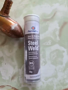

This stuff works great. A stud on the track punctured my snowmobile tunnel causing a coolant leak 4 years ago. This stuff fixed it even with coolant leaking out. Still holding to this date.
  • [Hearth.com] Garn  Leaking water again.
Just quick up date. Silicone is still holding so so. Losing about half a gallon in 24 hours. Haven't got a call back from Garn. Just called again no one answering the phone so left another voice mail.
