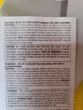

I took a snapshot of the instructions. Its only rated for upto 250f constant and 300f intermittent.
500-600f will be to hot for this product.
Thanks for the information. Sounds like I better pass on the Permatex steel weld. I will keep the JB weld high heat handy if needed.
