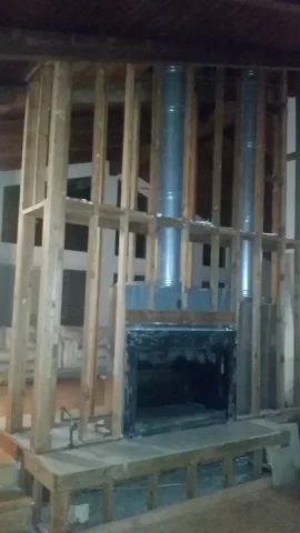

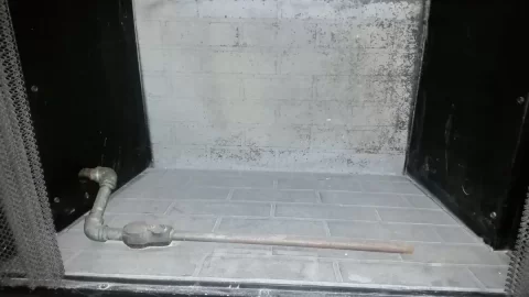

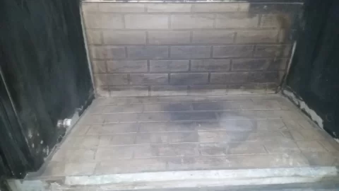

Hi,
We just bought an 80's home that has two gas fireplaces on each side of the wall and we'd like to update the starting methods.
Can someone please share what would be the most affordable way to either convert it to a wall switch or remote control start?
If you could share what parts we'd need and the model numbers, I'd owe you one!
Thanks,
David
  • [Hearth.com] Gas fireplace starting help.
You have log lighters, not gas fireplaces. I don't think a remote will work on the set up you have, & they are not heater rated appliances.
If you remove the log lighters & install gas log systems, you CAN use a remote, but not a thermostat remote, for the same reason. Gas logs are not heater rated either.
If you install gas DV inserts ($$$$) you can use either wall thermostats or remote thermostats.
