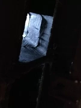

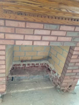

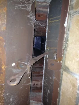

Here are photos of the existing fireplace.
We removed the hearth in the process of repairing the floor from the flood... water seeped under the existing wood and needed to be dried out.
We will be putting a stone veneer over the brick fireplace on the interior.
The wood stove will sit in the existing firebox.
If we can use the existing chimney, that would be a lot simpler.
Let me know what you think!
Thanks!
  • [Hearth.com] Gas Fireplace to Wood Stove
Looks like a true masonry fireplace. The best bet is to get the chimney cleaned, then drop and insulated liner down it. The gas line can be capped or removed.
