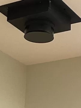

Possibly dumb question. Just picked up a 2003 Enviro Westport free-standing gas stove. It is designed as direct vent (4”/6” coaxial pipe). I want to test this thing out for a season and not have to modify my existing, roughed-in class A wood stove chimney. Can I just run some 4” single wall from the stove to the chimney ceiling flange and install a 4 to 6” adapter up there? Then just let the stove breathe interior air from the top of the stove fitting?

No. Direct vent venting needs to be sealed and continuous from the appliance to the exterior, using only tested and listed components for the respective appliance.

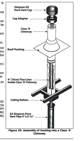

I do. It does not mention this. Basically just shows an option of the coax pipe going up a class A chimney with a funky chimney cap that allows the intake and exhaust to work properly .

That is what i was looking for. Yes, that is a newer model. What is the spillage switch looking for? Thanks
