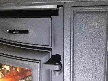

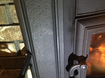

[Hearth.com] Gasket leak? i have done dollar bill test on my door gasket an it comes up tight in most spot, but allows the bill to be pulled out with slight effort on door side. I noticed today that I have what looks like soot marks just outside of door on that side. I will replace gasket as soon as possible. I was surprised to see this as I figured any small leak in gasket would only allow air in stove. Not sure exactly how long marks have been there as this room is typically pretty dim, but I do not think it has been there too long either. Otherwise, stove appears to working well with dry wood and no blockage of liner or cap. I have not noticed smoke in the room when stove is in operation.
While I have carbon monoxide and smoke detectors in the house, is there reason for concern between now and when I can replace gasket? Mainly wondering if carbon monoxide is a concern here.
To confuse matters, I noticed that I have similar but smaller marks on other side of door where I know gasket is tight against dollar bill. Any insight would be appreciated.

wanted to update/refresh this thread. I see indentation throughout most of door gasket. The spot (about 1.5 inches long) where I see little to no indentation is where I have dollar bill pull out pretty easily. The bill will be held up by the door, but with small effort it can be pulled out. When I did incense test, I was not seeing smoke getting pulled into that spot. Stove appears to perform fine.. I realize one way or another, this will need addressing at some point being that I'm guessing that a small leak may be present. With small gasket leaks like this, should there be a concern regarding carbon monoxide? I have CO detectors, but still curious.
Where there is smoke there is CO. Highly likely it's such a minuscule amount it won't affect you or trigger your detectors.
I wouldnt worry about it unless your stove starts to run away on you.
