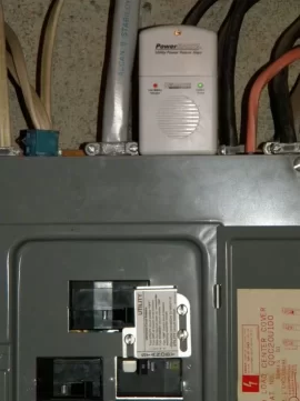

For those of you using the generator interlock switch where you turn off your main and turn on the generator
breaker...
How do you know when street power returns?
breaker...

warmncozy said:I use a "PowerBACK" alarm from Reliance. You just wrap the cable from it around the main power cable coming into your circuit panel and an alarm sounds when the power comes back on.
PowerBACK Link
Dougsey said:warmncozy, That's perfect!
