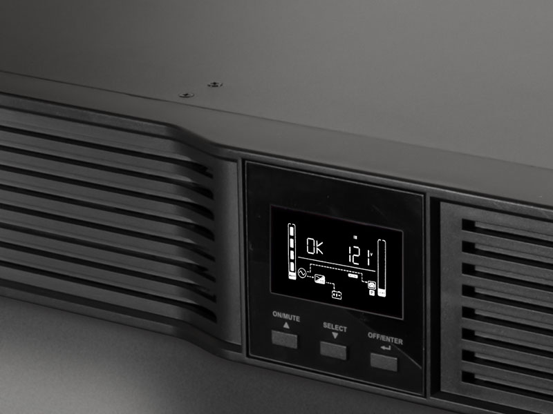

Mid sized generator and plug an APC into it, no need for a pure sine wave generator, the apc takes care of it.

Pretty sure APC is a brand name. The company makes UPSs which are fine for short term small needs.
