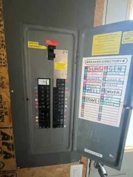

Been debating a few things since buying this house 4 years ago. The first summer we lost power for nearly a month and lost just about everything in our deep freezer... Had BBQs and gave some away but people are funny over getting free meat.... Id be leary too from strangers not knowing how its been handled so dont blame them.... so most was used for dog food .
Anyways, we have had a few days outage during the winters as well , nothing really major yet BUT want to be prepared. Pellet stoves wont work without power and wood stoves wont heat the whole house without circulation of some sort ( fans )
Well, I finally did what Ive been wanting to do since the first major outage we had as it sucked staying with someone ( camped out in their living room for nearly a month ) I purchased the Biggest generator I could find 13000 watts , Interlock, Inlet box.... And got it all connected to the Service Panel, Powering the entire house including septic and well systems without having to shut anything down as the wattages of everything is less than the running watts and well below the starting watts. This house is very well insulated due to the Winterization Program and the new HE HVAC system we can stay comfortable for the most part in an emergency.

The house I live in now (about a year) was already wired for a 30A generator at 240V. It goes into an emergency panel which goes into the main 200A panel. I bought a large Firman 8000W that I can use (just in case). Also, you could run your pellet stove with an inverter and 12V battery for awhile, which would give you enough time to get the generator up and running. BYW, most people would not be able to run a normal house load on a generator. ie electric stoves, AC, Heat pumps
True, Luckily Ive done a ton of research ( disabled on limited income ) so this house is very energy efficient with LED lighting, High efficiency HVAC unit, Weatherized to the max ( new extra thick insulation in attic. windows/doors sealed, and every little crack n croonie airtight ) My electric bill is under $50 during the winter and under $100 during the summers with mostly 100 degree + heat. Propane fill up runs me $500 a year ( Furnace and water heater ) I do a partial fill in april to last the summer since it just runs the water heater and a full fill late November to last the winter, all appliances are HE so the wattages are lower than most which helps a lot. The only added draw was the new septic system as the county changed the rules from the gravity systems to using pump systems ( runs full time with aerator ) but only seen about a $10 increase on electric bill for the past year.
Yes, I have thought about the inverters/batteries in the past, but I decided if Im going to do this its best to just go all out. All together it cost about $1500 for everything including the generator on sale.
May move in the future and when I do, I plan to have a whole house permanent generator installed with the automatic switchover, This manual stuff works but a bit of a learning curve ( PITA ) hooking up, turning this off and on and this n that.... when you dont do it constantly its a bit complicated.

Nice. My gen has auto and remote start but being portable I have to drag it out and hook everything up even in inclimate weather... I am planning to build a pad with a weatherproof/critter proof enclosue to keep it outside and opens when needed ( all 4 sides lift for venting/cooling and yet shield from the weather.
I installed a whole house Surge Protector in the panel as well... so its protected on and off the generator power.
That's a good idea re surge protection. I did the same. There was one in the panel similar to yours already, but one of the lights was dim. I bought one that is external, so I have two on my panel now. I don't have one in my emergency panel though. I would need something for my generator too. It is extremely loud and then there is the exhaust issue as well. I am in the city, but all the lines are old and above ground. It takes them a long time to repair after a major incident. Most people in the country have little generator sheds. There is a way to extend the muffler from the spark arrestor and get that out of the box. Then you need ventilation and air for the motor which is the same as ventilation.

I am a big fan of using an interlock to legally backfeed the panel from a portable genset. Awesome flexibility, capability, simplicity, and cheap! I am not a big fan of using such a huge gasoline generator. First, the backfeed breaker in your panel, is it 30 amps? 50 amps? Even a 50 amp breaker would only allow you to get 12000 watts to the panel but most are 30 amp so please check it. Then you've got to realize that this generator will be sucking over 1 gallon per hour of gasoline even lightly loaded. Are you prepared for that? Storing large quantities of gasoline can be challenging and buying gasoline during a power outage can be impossible. Especially if the outage is long term.
What I propose is a two generator solution. A little fuel sipper inverter (2000-3000 watts) for constant QUIET use which you can use to backfeed both sides of the panel with 120 volts and then the big genset for short term needs including 240 volt loads like water pump and water heater.
I wonder if you ever even need more than half of that 13000 watts with propane water heat and pellet stove.
In my case I use a champion 2500 watt inverter and a firman 8000 or whatever 440cc monster from costco. All dual fuel of course so I can use propane or gasoline. Storing large amounts of propane is very easy. Gasoline, not so much.
