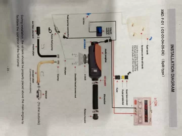

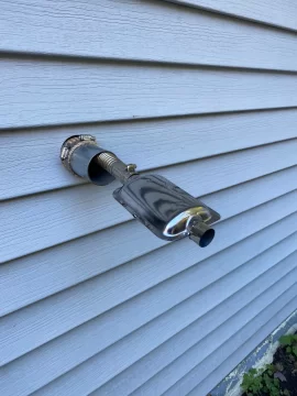

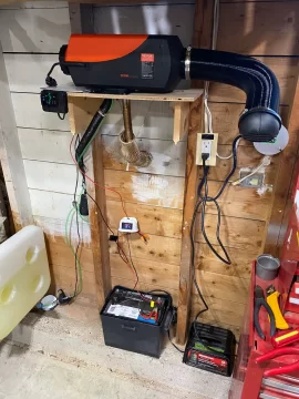

Mine is the split type. They have a suitcase one too. I kept my tank down low for ease of filling. I kept the heater high so I could get to the underneath. I have a little meter that shows volts and amps. It's good to have because the glow plug draws 8A on startup and they burn out once and awhile. The voltage is good to have. I will hook up a small 3A charger to keep it charged. The combustion air is supposed to be outside, but my garage is not air tight as I have ridge vents.
That's cool. I like the tank down low like you said for ease of filling. The air intake pulls cold air low and the blows away from the unit. The exhaust out through the wall. Yeah I like it. Is the garage a single or double? Just wondering how long the heater has to run to heat up the garage?

Just a lawn tractor battery would work with a small charger. It draws less than 10A on startup, but then goes down to about 2 amps. Some people use a DC power supply but they could blow. The guys that haul with the big trucks are paying big bucks at a fillup.

I have a workshop at the back and no insulation. I do have another diesel heater in the workshop area I got working today.
I also have 240V 15A for the garge so I have 4 1500W electric radiant ceiling heaters. I can't run them all at the same time, but
depending on where I am I can turn two on in the same area. This will be the first year with the extra diesel heater in the "automotive" area. It's just a single car garage but they added a workshop addition. I can't work in there in the summer as it's too hot. So fall and spring is when I can get in there with the heat to take the chill off. If it's -20C forget heating it unless it's an emergency.
