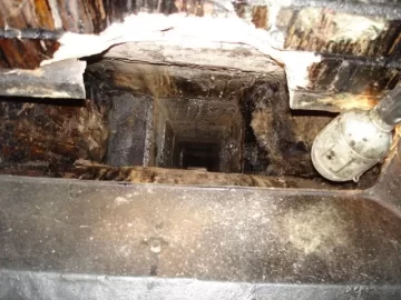

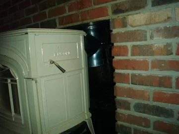

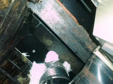

Yes a liner all the way to top and insulated liner is best. If you still have a damper frame in firebox it can be cut to make more room for the liner too pass through. I have pics of the damper in mine after I cut it wide enough for a 8 inch liner. Also a block off plate is recommended as too stop all the heat from rising up and out of top.
What a great post, sometimes its hard for new members to understand what we mean, you backed it up with pics.
