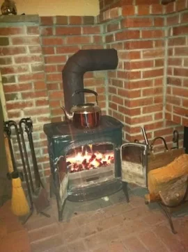

I have a VC Intrepid wood stove in my apartment that works great. Only problem is when I open the top to put wood in, I get a back draft and smoke comes out of the top and into the room. When I open the front doors I don't get any, just when I put in from the top. Do you think its cause of my elbow in my stove pipe? Is it because I dont have enough draw? The chimney goes from downstairs to upstairs (where my stove is) and then about 4 foot from my thimble going into the chimney to the top of the chimney. I've attached a pic, what do you guys think? Any help would be greatly appreciated. Thanks a lot!

are you opening the draft all the way and waiting a minute before opening the door?
Paulrd27 said:
...and then about 4 foot from my thimble going into the chimney to the top of the chimney.
No way is 4 feet of chimney enough. Most stoves need a minimum of around 15 feet.

That's what it says but would a stove work at all with 4 feet of chimney?
Yes I open it and wait a bit before I add more. I usually shut the doors first then open the top, it seems to have less smoke. Also, I would say that I have about 6 foot but thats no where near 15.
Just barely.
Actually VC spec says 16 feet from the flue collar but then one must subtract 3 feet for the Tee, 2 feet for the elbow, and 2 feet for every foot of horizontal pipe... almost negates all 9 feet of vertical...

If I understand correctly, the 4' you are mentioning is only from the stove to the thimble, correct? How long is the run from the thimble to the top of the chimney? When was the last time the chimney was swept?
6 feet.

Yup, as others have noted earlier, that may be the root cause of your issue.
Do you think it would be better if I switched over the back of the stove so it comes out the back instead of coming out the top? I would obviously have to change where the thimble is on the chimney. What do you think?
I doubt it would help and would probably make it worse. Changing out the 90 elbow and horizontal section to two 45 elbows and a short diagonal section would help a bit. You would probably be better off adding a flue extension to the top of the chimney.
Is that single or doublewall smokepipe? If single, switching to double would keep a bit more heat in the pipe to aid the draft. Each suggestion should result in a small improvement so combining them should net better results.

To clarify, this is a VC Intrepid. It, like other VC stoves, offer top loading. Once the stove is up and running, this is the way you reload the stove. If you open the griddle partially, pause, and then continue to open the griddle to top load, smoke should not exit the stove with a good draft. If the stove damper is closed, smoke will flow out heavily.

No, if anything it would make it slightly worse since you are adding another bend.

I have used the Intrepid the previous two years. You have two 90 degree turns and an extremely short chimney. That is your problem.

My feeling is your draft won't have much strength with a four or even a six foot run no matter how hot you get the gas temps. VC stoves will smoke when you open the top load door if the draft is not strong enough. I have a strong draft and I not only never see a whiff of smoke come out when loading, the flames will lick past the smoke shelf and whip right on up the flue in a very intimidating fashion. Too much draft, maybe, but I get plenty of heat coming off the stove, so I am happy with it as the stove never runs away or reaches overfire range.

To avoid the smoke kickback when you open the griddle. Open the air fully, wait a 10 seconds or so, crack the griddle half and inch for a couple of seconds and then open it all the way and toss the wood in.
The height of the flue with the number of bends is only half of the equation. The other half is the building envelope and where the neutral pressure plane is. Try opening a window.
