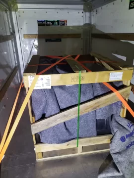

Hi all,
Almost ready to get my stove installed. Just went and picked up a princess 32 yesterday thanks to the groups help! It was between a blaze king and lopi. Now I need to get the chimney pipe and stove pipe before my scheduled install in about 2 weeks, so need to order pipe asap. My installer mentioned duravent and Jeremias but said I can get any pipe I want. Since I didn't tell him yet, he just went ahead and quoted me for duravent.
Im wondering what pipe you all recommend? Is the Jeremias worth it over Duravent - Don't really understand the differences other than the metal being a better stainless steel.
Im looking for a pipe that has good insulation to keep a good draft, has good connection points that won't easily come apart during chimney sweep and wont leak easily, and maybe one that is safer to withstand a chimney fire.
I'm not trying to get something super expensive that's going to last 100 years, but I want something that will perform well and be headache free for years to come.
Any recommendations are greatly appreciated.
