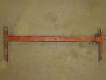

A couple pieces of scrap steel! Measure out 18 inches, two welds and a good sharp edge on the the end points and I am good! OH YEAH don't forget the orange paint so when you drop it in the grass or leaves you can find it! Cost me no money and 15 minutes of my beer drinking time! :coolgrin: All you do his hold the two end points one in each hand, and with sharp ends down, scratch out 18 inches, then jump down, scratch, jump down scratch! Nice and consistant! Your marks won't wash off or disappear, as long as you scratch hard your all good to go! :coolcheese:

So how do you use it? Scratch marks in the bark?
Yes just scratch the marks in the bark! I start at the fat end first and work my way up! Then I cut cut cut! Consistently 18" long! :coolgrin: What you think? Simple and cheap!
