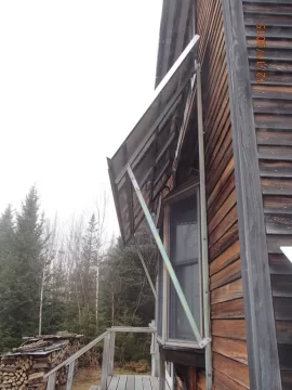

I must admit my original array which is hung from a wall does have an issue with shading from a roof overhang in early and late morning as the sun makes its way to the summer solstice. One of joys of living near 45 degrees latitude is that the sun angle varies significantly from winter to summer (which is what gives us seasonal variation). If you look at the tables or a sun plot you will see that as the solstice approaches the sun actually rises north of east which means fixed south facing panels lose out. My wall array and my ground mount miss out on that early morning sun but my roof mount which is at something less than 30 degrees off horizontal actually kicks in production a bit earlier in the AM during the summer as it can take advantage of that early morning dose of sun. That is quickly offset by lower panel efficiency later in the day due to far hotter roof than my pole mount.
[Hearth.com] Getting harrased by solar panel sales people due to my solar potential with aerial imaging. .
The trade off on lost summer production is that snow sliding off my roof panels clears the wall mounted panels when it slides off the roof when I am set at the winter angle. If you look carefully you can see the holes in the unistrut that corresponds to winter, summer/fall and summer. The bottom hole is "hurricane mode" which stows the panels right up across the bay window. One unplanned benefit of this install is in the summer the sun shades the front wall and really cuts down on AC usage.

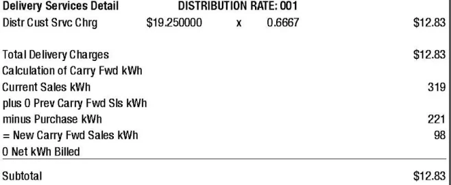

We just got our first electric bill. 2 weeks in and 98 kwhs in surplus and $12.83 just for the connection charge. Here in CT with the highest electricity prices in the lower 48 this a welcome relief.
