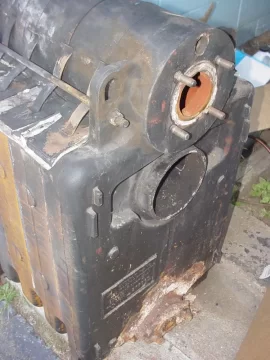

I paid about $1200 for the brand new 4 section cast Buderus Boiler assembled at the Londonderry NH plant. That does not included the burner and controls.
Anyway, either of those stoves should heat your house. The quad is a great stove with basic controls. It does work very well in the Auto-On/Off mode using a regular T-Stat. The Harman of course is the better stove with more controls. There is a difference in cost!
