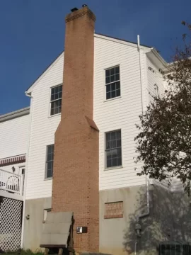

We did one OAK all the way up the chimney next to the pellet liner. Used SS flex for the pellet liner and alum flex (made for gas inserts) for the OAK. At the top we switched the pellet pipe to rigid and extended it up 2 ft or so, and kept the OAK down low to the top of the chimney. I had planned to just seam two 3" top plates together but the installer brought one of them back, I have no idea what he did up there to seal it off.

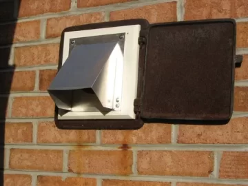

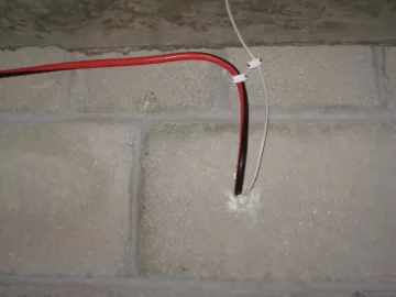

The ash cleanout slot on the floor of the fireplace just opens to a large pit where the used ashes can be deposited. There is a cleanout door outside where I put a termination like a dryer vent (but with screen to prevent bugs from entering). I removed this vent and closed the cleanout door during the summer. On the corresponding inside basement wall I drilled a hole through the block and brought in the electric and thermostat wires. Since the AE can also be run directly off a 12 volt battery, I am thinking of running wires for that too, but that will be a real pain now that the insert is in place. Here are some pics:

Kadet40. very nice. Good idea with the OAK. Most of the ones we run into the clean-out is in the basement. It is a good idea to be able to close the OAK when not in use, they are not 100% air tight unless you use a lot of silicone caulk where it mounts on the unit.
Kadet40,
Neat job and a good use of what bwas available!!
Ranger
Kadet -- That is an absolutely superb install. I love the clean look on both the outside and the inside. Unfortunately, my ash clean out door is on the inside. I would have to run the oak down the ash hatch to the inside door, then run it through the door and then back up the inside wall until I find a spot where the concrete foundation stops and I could cut an exit hole. I'm thinking it's just easier to go up the chimney.
