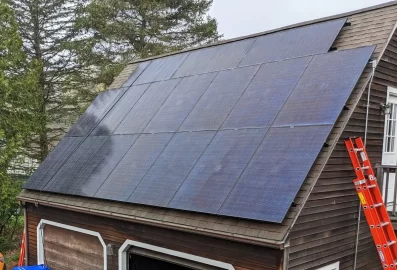

Got out system installed back in April, and it finally was turned on last week.

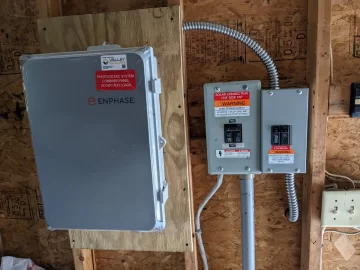

We ended up going back to them challenging the idea that we needed another conduit when we both have an existing one with plenty of room for more conductors and that the garage has its own sub-panel with 50amp connection to the house. They never really got back to us on it, but when the electricity came the 2nd day he asked to see the garage subpanel and wired it like this.

Supposedly called a feeder tap and looks like it just shares existing garage circuit. Was nice to get the $500 trench fee back.

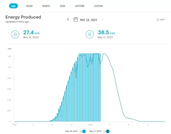

I am somewhat wishing I tried to push for higher rated inverters, the clipping makes me sad :(

We get clipping too, but the inverter was a good deal at the time and has performed well. Enjoy the solar watts.

I probably will never see clipping. Not that it won't happen, I just won't be able to tell for sure - who knows, maybe there will be a tell-tale that I'll recognize once I get more time understanding the usage charts. I have a hip roof so have panels on 3 sides. I have some shade on the east and south sides, so need the micro inverters there. The west side has no shade. Oh, now that I think about it, with the snow we get, I'd have to have microinverters regardless. I had plenty of days only portions of panels had cleared off and they still produced while the other panels were completely dark.
