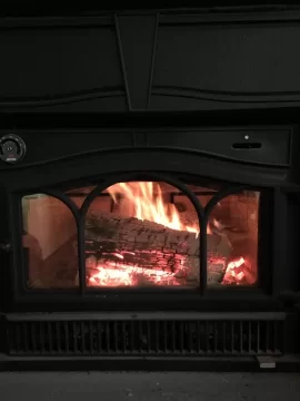

I have a Jotul 550 Insert - and sometimes a large piece of wood will tumble and lean against the front glass. Should I have any concern that this bright red burning piece of wood is full on burning against the glass?
The wood doesn’t come crashing into the glass - so i’m not concerned about that - its the heat rating / will the glass shatter from the intense heat.
no stove glass isn’t subject to thermal shock like normal glass rapid heating or cooling won’t do anything ( impact and flexing are the weak points of robax and ceramic glass)

I believe it's not glass as we're usually familiar with such as pyrex, but a clear ceramic. It can be heated to far greater than stove temps and not loose it's form or become brittle.

Never had a problem with that. Just don't slam the door onto a split sticking out too far.
My Rockland does this more than I would like. Firebox designed for east-west burns only and the andirons are useless. Wood against the glass here and there is ok. Just don’t get anal and open the door thinking you can fix the issue in progress, as the wood is likely to fall out of stove.

Happens to me occasionally as well. I can only burn E/W and when it does I gauge how long it would have to be like that, meaning is it kinda coaling or still a have to burn awhile. My hearth really heats up a lot more when that has happened as well. So, I put on the gloves, then barely open the door trying not to let it completely fall out, then squeeze the fire poker thru the little gap and hope to hold/catch as much as possible then grab it and maneuver it back in the box. Usually there's a little more mess, so scoop the coals and dust off. You will remind yourself when you load the box next time to be aware of how it's going burn and strategically place the logs in the jigsaw fashion a little better.
As mentioned, the thermal aspect is nothing to worry about. Sometimes a fresh piece of wood near the glass will leave a tar / soot stain that is hard to get off - unless you're planning a good hard 'glass cleaning' burn, anyway.

No worries . . . as mentioned the material is actually a ceramic or similar material and is extremely resilient in terms of temperature and even an occasional blow.
About the only time I hear of cracked "glass" is when someone rams their poker into it or attempts to slam a door shut with too long of a split or round.
