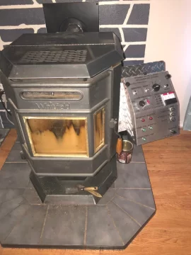

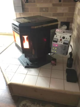

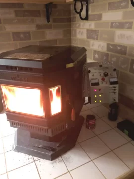

My Whitfields both skunk up the glass within a day.
THE large stove has been used several days to get this dirty and the small one has 2 days on it.
Good clean airwash passages help...as does a good flowing chimney.
My stoves are both direct vent....and this tends to reduce the draft of air a bit.

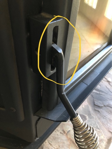

So I did the dollar bill test and it passed. I used a smoke machine to check for leaks. I found one.... but not around the glass as I was expecting. It’s coming from the door latch! I don’t see any seals or anything on the inside. How can I fix this? Do I even need to fix this?
[Hearth.com] Glass sooting question
Id say it’s fine. If everything is clean and your burning good pellets, that’s probably as good as it’s getting
