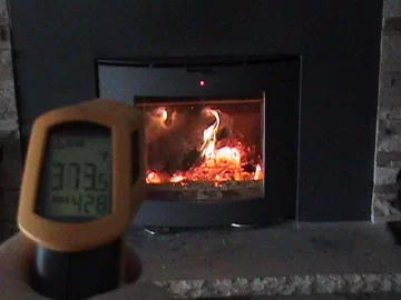

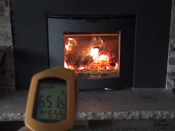

Since I have an insert and not much of a stove top which would be the best place to measure? I have measured around 900 on the glass before and usually there is a 300 degree difference between the glass and stove give or take. I have had 2 broken/cracked baffles in 3 years and wonder if I'm over heating or if they aren't good quality.

I measure my glass with an IR thermometer also.
I have NEVER seen 900+ - I usually peak around 700 then settle and cruise between 650 and 450. (again this is IR measured on the glass)
I'm guessing that you're over-firing.
Try cutting back the air sooner and cutting it back more.

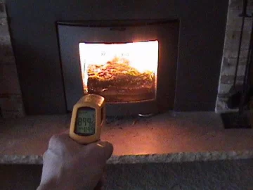

But - would you agree that 900 on the glass is way hot? I'd have to load up with my black oak on top of hot coals and leave the air wide open for a long time to get that.
Not gonna try....
Here is a temp at 899 with some doug fir after about 10 minutes. Primary air closed and secondary open. No other wood I use gets this hot, not even locust.
