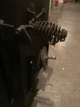

What is wrong with using a stainless liner with a non-epa stove? My creosote problem is because I can't keep the oversized clay liner hot enough all the way up and out even with my "smoke dragon" so creosote forms mostly at the top two or three tiles. Anyway, short answer, yes I intend to keep my current wood furnace at least for a few years yet. I have modified it so it no longer relies on a thermostatic draft control, it now has a screw knob so I can put it where I want it and it stays. And I run it hot so now it runs pretty clean, very little smoke even with my marginal wood. [Hearth.com] Glazed creosote and new liner

The liner will make a fantastic improvement in the burning characteristics of that ole furnace. In fact keep an eye on it for a while. You will have to re-learn how to control it with the improved draft.

What is wrong with using a stainless liner with a non-epa stove? My creosote problem is because I can't keep the oversized clay liner hot enough all the way up and out even with my "smoke dragon" so creosote forms mostly at the top two or three tiles. Anyway, short answer, yes I intend to keep my current wood furnace at least for a few years yet. I have modified it so it no longer relies on a thermostatic draft control, it now has a screw knob so I can put it where I want it and it stays. And I run it hot so now it runs pretty clean, very little smoke even with my marginal wood.View attachment 168960

Didn't realize it was a furnace that runs hot (not that you were obligated to mention that in your post). When I think smoke dragon, I think of my neighbors burning long smoldering fires all day, and with the smaller surface area a liner would create I'd have to imagine you'll be cleaning it A LOT. I'm not saying it wouldn't work or improve the draft or be unsafe, just that it seems like it'll create a hassle. But sounds like that won't be an issue for you.

Putting a properly sized liner on any stove regardless of what it is will make it able to preform better. Now if you still use bad wood and poor burning practices then no a line rwont fix it but a liner will make it much easier to burn it correctly and to maintain it correctly
