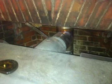

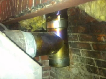

The liner was glowing red. I don't have much of a stove pipe, just a T to connect the stove to the liner. I've attached a picture to show how close the liner is to the stove.

Seeing the discoloration on that Tee and liner, I'm voting small chimney fire.
I would pull all of the pipe - clean it - inspect it - clean liner and if no cracks are found, reassemble and burn away.
Check the flue output on the stove for any signs of cracking as well.

Thanks guys. I'm just waiting for the stove to cool down so I can check it out. Hopefully there will be no problems as it is supposed to sub zero temperatures here the next couple nights. The discoloration on the Tee has been there since just after the liner was installed last fall. I tried putting the magnetic thermometer there but it wouldn't stick (not SS?).

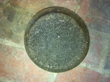

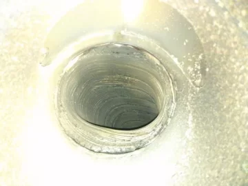

Just an update... I did get a chance to look over everything and it all looks good. I got a little bit of black flaky stuff out of the bottom of the Tee. The liner didn't look damaged at all, at least to me. I got it all hooked back up for the sub zero temps over the weekend and have had no more problems. I've been letting it get going with the air intake only half way open and it heats up just as quickly (about 10-15 mins to get to 600-650 stovetop temps) and doesn't sound like an jet taking off anymore.
