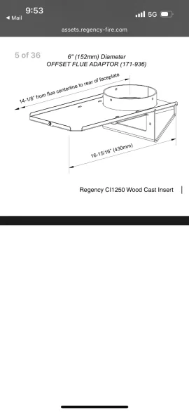

The manufacturer of the stove also sells an offset flue adapter that would set the center of the flue back another 5”. Maybe it’s best to go that route?
You have 5.5” liner (undersized) if you are not over 20’ the offset box will further reduce draft. I vote adapter. But it’s hooked up and the liner didn’t come apart making the connection so not working, correct. Are you just not like the looks or are you trying prevent something?
The manufacturer of the stove says 5.5” or 6” liner is acceptable with this model stove. It’s not an offset box, it’s an offset flue adapter that manufacturers sell. I installed everything last year and was able to burn only a few times. The draft was good with no problems. My only concern is if it is okay for a s.s chimney liner to flex that amount to hook into a stove? I just want to make sure everything is good before I go ahead and install a steel block off plate.

No it is not bent as tight as it came in the box. I just has a S curve to it. Here is the part the manufacturer offers to help get rid of that. If you look inside the firebox the liner comes down and is flush with the appliance connector.
