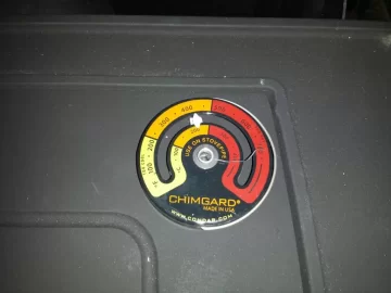

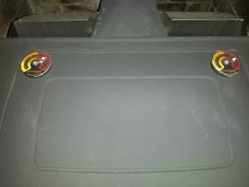

As far as temp checking, this is the proper placement of thermometers.
[Hearth.com] Glowing stove pipe

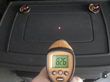

With the thermometers in those spots, 700 is a good number to hover around. I don't like going higher than that but I have hit mid 700 a couple times. I made a high temp gauge to let me know how how it got over night. Just a bent up paper clip.
With the temps around 700 on the corners, the middle gets hotter. But I checked with jotul and that's all good.

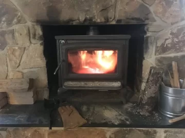

Hi Guys.... going to bring this one back instead of another new thread....
Is burning less than ideal wood (30%) a contributor to high liner temps? My wood is less than ideal. I have been supplementing with 2 large Biobrick XL on top of each load and I am able to get good burns and i can fully close the air once the bricks catch. I have no smoke from the chimney after the normal 15 minute startup period. Get great temps up to 650 with damper fully closed. BUT.........
I've been fighting my liner heating and glowing WAY too quick. As in a minute of full load up and flames, the liner will glow about a foot up. The elbow and connector are not, but i have about 1" of corrugated pipe that I can see below the insulation and that glows. I have to be 100% attentive and sitting by the stove with my IR gun on each startup to manage the situation. As soon as the bricks catch and I damper down, everything is perfect and it cruises great for 12 hours. But the first 10-15 minutes of each load are a little unsettling...
My thought is..... the full load of less than ideal wood is producing TONS of wood gas. This gas is being ignited and burned by the burning biobricks. The ignition of the wood gas is taking place 1-2' up the liner instead of the firebox?
(Please no comments about burn seasoned wood. I know my wood isn't great and I have 10+ cords out back I have split from Oct. seasoning, but I'm trying to get through this winter as this second stove was not installed/planed until October)
