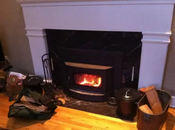

Just wanted to say thank you to all of you who helped in my decision process a few weeks ago as I shopped for an insert, as well as for the wealth of knowledge in your archives on all burning issues, etc. I ended up getting the Hampton Hi300 (picture attached-hopefully). So far, so good I think-still trying to experiment with settings, fan-speeds, and wood. Just got a bunch of seasoned oak which is really burning much hotter than my prior stuff, and find myself foraging through my wooded area "stocking up" for next year and ordering IR meters and moisture meters online. In between her telling me to clean up random ashes and wood from the living room, my wife thinks that I may have a new obsession. I think that she may be right...
I did have a couple of quick (newbie) questions as I continue to experiment which I'm hoping that you could shed some light on...
1. Still haven't been able to keep an overnight burn going. This is my process (which may be flawed): I start with really hot coals, rake them to the front (towards the door), pack with wood while trying to leave gap of about 1 inch from the pipes for gas burn. Run wide open with fan for about 5 minutes, close down to 1/2 open (also tried 1/4 open), and end up with a only a few coals in the morning. Still have to basically start the fire from scratch. This is with the fan on the whole time (which I need to circulate heat through room and up 5 stairs to bedroom). Owners manual says to never close down less than 1/2 with fan on. Any thoughts on technique improvement?
2. Overall, does the fan being on affect the temperature of the fire? Will it stay hotter with it off?

Read the manual. Minimum is a quarter of an inch out.
Looks beautiful by the way.
Takes practice Newt, I dont have a secondary burn so I cant help you with specifics but I can say you'll get better with time, also you should make a huge dent in your heating bill, I went from 1000 gallons of oil down to one tankful a year, my first year wasnt as good since its a learning process.
Nice looking stove and set up, good luck.
