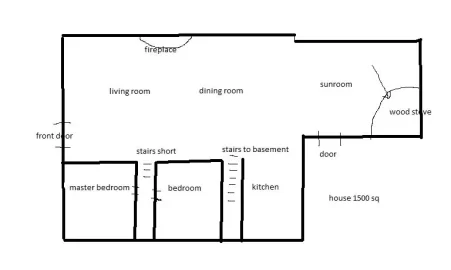

Planning to install wood stove but have no idea about place and model.
Price range 1000-1500 for the stove.Plus 500 for pipes and 200 for pad.
Small and old house (1500 sq) with lots of new windows and skylights.
This is the plan
Thank you.

If you could place the stove in front of your living room fireplace it would likely do a better job of spreading the heat than it will if you place it in the corner of the sun room. Adding a paddle fan above the stove placement will do a lot to help move the warm air around. By using the reverse setting on the fan you can experiment with the speed to get the best results.

My wife absolutely disagree with this.
She want to hide this ugly wood stove in small room:(

If you are planning to do the installation yourself why are you discounting the idea of a stove or insert in the living room? Do you already have a chimney/flue set up in the corner of the sun room where you penciled in "woodstove" in your diagram? If not, it might well be easier to do an installation using a flexible SS liner down your fireplace chimney than installing a chimney/flue from scratch in the sun room. I've done both installations and my liner down my chimney was easier than my "through the ceiling and roof" installations.

If you are considering only a freestanding stove, how will it be vented? straight up or out the wall and up? Will you be able to achieve at least 15' of flue total? Out the wall and up is more expensive and will affect draft. If that is the case I would not hook up an F400. That stove likes good, strong draft.

In sunroom the easiest way to install the pipe.
Thin and low ceiling.
And this F400 comes with all pipes.

Does it include all the fitting for a straight up install including the chimney's ceiling support box? Often they don't survive well unless removed carefully. How tall will your chimney be? This stove is going to want a minimum of 16ft straight up.

Everything comes with stove.
Chimney will be from stove to the end about 14ft.Is it not enough?
From manual:
[QUOTE
Chimneys shorter than 14 feet (4.27 m) may not provide adequate
draft. Inadequate draft can result in smoke spillage when loading
the stove, or when the door is open
][/QUOTE]
