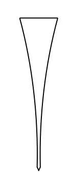

I think I must be going crazy. I have a splitting wedge that is about to give up the ghost, and I cannot find another like it. All the other ones I've tried do not work as well.
Here's what's special about it, and what I think makes it work better than others: The sides of it are slightly convex, not just straight (see pic). I think that allows it to get firmly stuck into the log before it starts widening out and doing its work. The wedges I've tried with the straight sides, even the ones with straight sides plus little serrations, tend to go in an inch or two and then next time I whack 'em, they just bounce right out of the wood. It's exasperating.
Another thing about mine, probably not as critical, is that (if you look at it from the other aspect as my drawing) the sharp edge flares out some, is a bit wider.
Anybody know where I can find one of my old one ? Am I the only person who still splits wood by hand ?

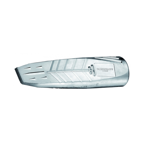

I'm not sure where to find the wedge you posted in your image but if you're willing to try another design, I would highly recommend the European twisted wedges made of aluminum:
[Hearth.com] good splitting wedge
This is the one I use and it's worked better than anything I've used previously!! It takes a moment to get it started in the wood, but once it's in there the twisted design "spins" as you hit it and just pops the wood apart. I've successfully gotten apart knots and crotches with this, and all manner of pine!

I mushroom the heads on steel wedges with the 10 pound sledge, I am sceptical of how an aluminum wedge would hold up.
I borrowed an aluminum one from my neighbor, and I do not like it (not a skinny enough taper so bounces out) but it seemed remarkably tough.

A little time with a right angle grinder or bench grind might cure your difficulty on the straight side wedges. Another wedge to try is a torpedo wedge in steel not alum. About $20 on Amazon likely close to the same at various stores as well. i've had one for about 20 years. I do not split much by hand anymore, body parts protest, have a hydraulic unit. once in a while something gets real stuck on the splitter and needs some special persuasion.

Wait, remind me what is a "torpedo" wedge ? (It IS my favorite beer). The wedge from post #8 is looking good in preliminary testing here.
