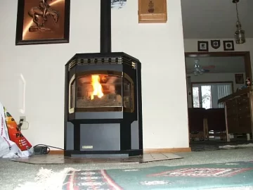

The new Harmen Advance arrived yesterday. It was also , windy. and snowing. Getting around the cleanout "T" was easy once it was setting in place. By the time I got the stack all connected up and sealed and did a little cleanup the house was down to 60º. Turned it on and as advertised the fire started on it's own a few minutes later. Big fire and the heat poured out! as soon as the temperature reached about set point the fire dimimished and the temperature stayed at 72º. This morning I got up to an outside temperature of 19º. The house temperature was still 72º! I could get to liking this!

Well, for that much money it ought to look good! :lol: Actually I was rather taken by the appearance also. It looks a lot like my old Gloking.
I have burned it continiously since it was installed Wednesday and to date only a small area of brown on the left glass panel. Last night the OSA was a cool 16º and the house stayed at 73º, just where I set it. I'm very impressed with the way it modulates the fire in accordance with the difference in room temperature and setpoint.
The log kit was out of stock but the dealer called me last evening and said it was in. It is a $90.00 option but was thrown in to sweeten the deal. I'll report on it and put up a picture when it's installed. Also I'm waiting for the weather to warm up during the day to see how it operates as far as automatic shutdown and startup are called for.

The cermac log arrived as promised. It mounts to a sheetmetal shelf that screws to the door. I was not impressed with it and was about to take it out when SWMBO saw it and exclaimed, "Oh that looks so much better". The stove is working well as advertised. My only negative comment so far is that the distribution fan is noisey.

Only problem with that exceedingly delicate log...dont drop it!.....is that it gets covered in ash REALLY fast, and ceases to look like a log, but a weird pile of ash. Also seems to cause the glass to foul faster.
