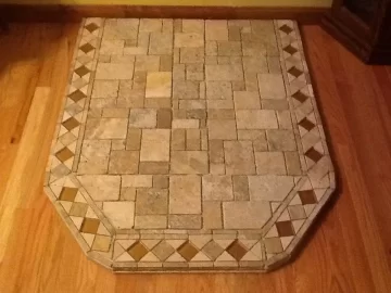

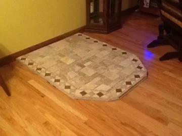

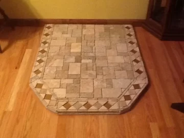

Tomorrow the top half goes in, or "on" the wall. I know that without pics, it didnt happen so here ya go. I owe the design to my dear wife, i just ran the tile saw, the circular saw, and the thinset...

Those copper tiles in the border are actually amber glass. It looks pretty nice if we do say so ourselves

Looks good!
I did notice a long joint line from front to back close to the middle but I'm sure it don't matter.
Did you grout it yet?
On second thought you would prolly wait till the back is tiled.
Thanks! The long line wont be so noticeable once the stove is on it. ;-) we will be grouting it tomorrow once the tiles set.

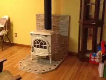

Well, the hearth and stove are done. For those that asked the bottom is 1/2 " plywood, 1/2 " durock nexgen, then 1/4" tiles

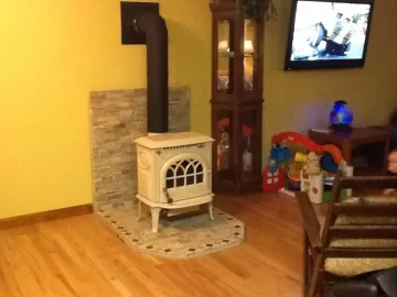

Well here are the finished pics

Very pretty. That finished out nicely. Good teamwork there.
I would just like to say "thanks" to all who have put up with my constant questions , rants, etc... I could not have done it without your help and support.
Looks darn good!
I might go for a guard or screen sort of deal with the kids around.. if for no other reason than to keep some of those plastic toys from getting parked to close.. lol.
Well, the toys are from the grandson, we have been teaching him slowly with the stove in place NOT to even step foot on the hearth let alone the stove. He is only 1 so... But he seems to be learning to go around it. But i will be thinking of a gate while it is burning
Wow - looks great!
-and thanks to your son for his service!
