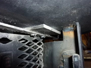

If you feel you would still like to be able to shut the air down further when needed, check and see what the gap is between the slider plates and the air inlet holes (I think you said .060" earlier.) I had more than that, in this pic I posted before:

WranglerBowman did something else to adjust the gaps between the slider plates and the air inlets, which I think would work well. He removed the plates, then he could slide the rod out and bend it up a little bit so that the plates would seal tighter against the stove and air inlets. You just have to go easy and don't over-bend the rods, or there will be too much friction and the rods won't slide easily. Here is WranglerBowman's post, and a link to that thread:
The rod slides on 2 guides at either end of the stove and metal plates slide and hit those guides at full open and fully shut so once you remove the metal plates over the are intake the rod can just slide out Then just slightly bend it till you have a slight upward bend, run it back through the guides and reattach the metal plates. It worked really well for me.
