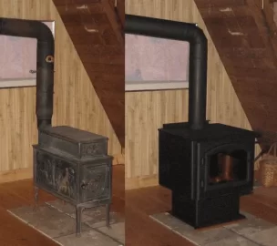

Out with the old, cracked and rusty Jotul, in with the new QuadraFire! Only had time for a small-medium break-in fire so far, but enough to get the paint smoking a bit and stink up the place. Already like the fact that the floor next to the stove stays cool, instead of too hot to stand on in bare feet.

Nice upgrade! Looks great, I hope it warms you up!

Maybe it's the camera angle, but that 90 degree elbow looks fairly close to the underside of those steps, which look to be made of wood. You might want to check the clearance and shoot that area with an IR temperature gauge to see how hot it's getting once you start burning some hotter fires.

It is the camera angle. That's actually the roof (it's an A-frame) and the pipe is closest to the rafter just visible in the upper right corner of the picture. After trial fitting the pipe, the installer took off an inch or so to lower the elbow specifically to get clearance. It's now good by 1/2"
Just about anything will be safer than having that old 118 cranking away in the corner. It basically worked by heating the inside of the un-insulated roof with radiation, which then heated the air (both inside and out I'm sure). I was measuring surface temperatures as high as 150 on the slightly combustible pine floor!

Nice! I noticed the door hinges on the opposite side vs. your old stove. Does that work better in your space or do manufacturers not offer left/right option?

It probably will work better in my space, but it wasn't an option. The holes for the hinges and door latch are stamped into the metal, so they'd need a different stamping to reverse the door.
It just feels weird to have a left hinged door at the moment. Every other front loading stove I've used has been right hinged. It's like suddenly driving a car with the filler cap on the other side.
