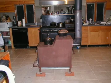

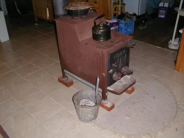

This was my kitchen stove where the original Goldilocks on pedestal was. I wanted a larger cooktop, so used this brown Mama Bear for a couple years until getting the kitchen Queen. The plywood subfloor is overlaid with 1/2 cement board, then tile. The R value is not enough, it must be double rock board, then preferably brick. It got uncomfortable to the touch directly under the center, so I raised it on bricks to gain clearance, still too hot. I had a bunch of fireplace damper clamps used for holding a damper closed when installing gas log sets. Had an old metal shelf just the right size to fit between the legs and sat it on the clamps. Stayed cold under stove!

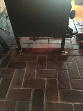

I set a second layer of brick under the stove. Top brick temperature is 142 degrees. Underneath that brick top is 120 degrees.
