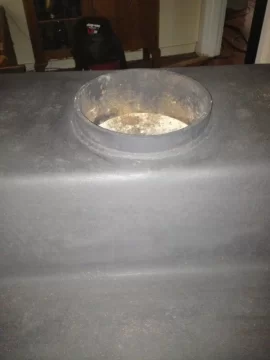

Added two pics of the inside that shows the brackets to hold the brick. My understanding is 4 on each side 5 in the back

Forget how I identified an older stove with flat top doors.
You have a Grandma III with integral shields made after 1980.
The Series III manual in sticky section has the brick layout in it.
The manual also has clearances and floor protection requirements.
fischermanual.pdf
The sealing area in center of channel iron looks clean.
The hinge pins shown installed at the top right and bottom left are correct.
You can get new, or I can walk you through how to easily make your own if you have a drill and bench grinder.
If there are threads on those bolts, do not use or move doors since it will wear the holes quickly. When you have correct hinge pins, grease the hinge pins with high temp grease or silver anti-seize.
Close the doors and latch the right side latch. The left door latch handle should not move.
Give us a picture of the doors closed and latched. We're looking for the angle of the door handles. (they should match, positioned at the same angle when latched) We can tell you if they are correct or if the latch rod needs adjusting, and how to do it.
When bricking a stove, vacuum or brush every thing out of the stove interior so absolutely nothing can get between the bricks as they are installed. Install bottom layer, rear wall, then sides finishing at front.
No pieces of brick or ash can be between any when installing. Any spaces will fill in with ash making them tight. Always burn on an inch of ash when removing ash.

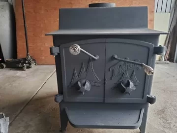

The left door closes perfectly the right drops lower and the handles are not positioned the same. I have a drill and a grinder

I learned from this forum I need brick on the sides and back but didn't realize I needed them on the bottom too. I will definitely clean the stove before installing bricks the seller sold it to me dirty at $200. I want to thank you for all the help, you're a great help to me.
Your door latch rod is wayyyy out of adjustment.
If you have a propane torch you can get the rod on the back side of the door hot enough to bend. It should glow a dull red. Heat the bend of the latch rod where it should be close to a 90* angle to latch on the other door when closed. Yours has straightened out over time and being over tightened. (people tend to push down on the door handle, but it is not necessary to tighten it more than necessary) It needs to be bent into a sharper angle. No more than 90* angle. If you bend it cold, which can be done without too much force, they tend to go back when heated with a normal fire. Bend It hot, and it will stay there. I use an adjustable wrench to bend when hot without too much force when hot enough.
Handles should be in this position when done;
View attachment 255700 Before View attachment 255701 After

Don't have a torch and the stove is in the house so running propane inside is not something I want to do especially with so many chemical sensitivities. Might be able to get help to move it to the front door and find a torch somewhere. Looks like the bolt on the right door is smaller in diameter then the left one so maybe it hasn't ruined the hole size. I will replace both of them either by modification or buy new.
The latch rod you need to bend is on the right door. You can remove it to heat outside if that is a problem. I do them on the stove to try closing before it cools down in case it needs to be tweaked a few times to get just right. No worse than soldering a pipe inside. Actually less smoke without soldering flux. Connector pipe is going to smoke off a lot worse than heating an inch of 1/2 rod. If you heat the door latch rod after hooking up to pipe and chimney, burn some newspaper in the stove to start a draft. Air, smoke and impurities in the house is drawn up the stack with doors open like a vent fan. Same as removing ash. Do it with a hot chimney and fly ash rushes into stove and up stack. The chimney is your vacuum cleaner.
Make sure the bolts you use are 3/8 with smooth shank from head to length needed and cut the threads off, or cut to the same length as the original hinge pins you have. You can practice grinding on an old bolt to get the hang of making round heads look right. Keep greased to prevent wear.
Didn't even think about removing the door! Will look for a torch…can't do it with fire, no pipe is installed yet and need to build a heat shield for the wall as well as a hearth. My pipe is all double walled 6" so will need an adapter at the stove top.
