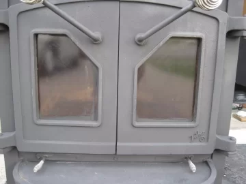

Series VI is only the single door stoves in the Bear Series. Double doors were I and II before glass and III and IV with glass.
Yours is a Grandma size, Series III glass is horizontal across top like this;
[Hearth.com] grandma stove VI1982 [Hearth.com] grandma stove VI1982

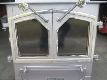

Series IV is angled as shown below;

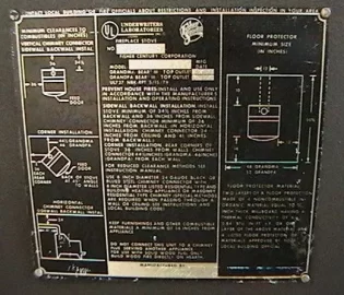

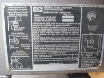

Clearance specs are on tag on rear shield. They differ for Canada and US. A Canadian tag has metric measurements as well.
Thank-you for the info. My doors are shaped like those doors in the III pics except the vents are on the top of the door above the glass. Is this a Canadian version of the Grandma III ? There is no plate or sticker. The doors also have a chrome trim around the doors and the fisher name is chromed as well. It came with chrome claw feet that fit on the angle iron legs. Also does the clearance for the pipe to ceiling change when the installation uses a 6" stove pipe instead of the 8 "? This install is connected to a 7" round clay flue inside a mason block chimney with a 6" thimble (connector) for the 6" stove pipe.

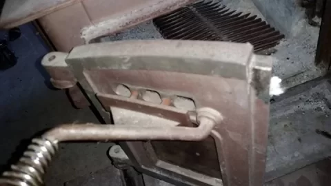

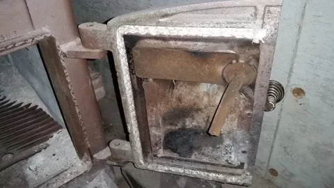

The first glass III doors had the intake above glass.
Are these your doors shown on this Insert?
They soon made the stove with a plate across the front with the intake sliders to provide air wash over glass.
